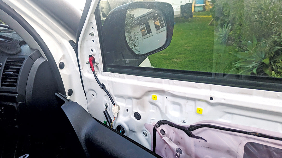

Fitting the mirrors is pretty straightforward, but I recommend a set of panel removal tools to keep your trim in good shape. Pop off the corner trim ahead of the window and unscrew the trim around the door handle and the door panel will pop off enough to get at the three bolts holding the Toyota mirror on. The GX has no indictor lights in the mirrors but there are wires to control the mirror movement which will need to be swapped over. Bolt on the new mirrors, fit the electrical leads and refit the trim.
