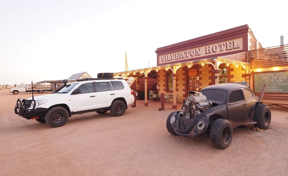

John Ford's upgrades to his 200 Series LandCruiser continue with a new bullbar, roof rack, power source and UHF radio now onboard.

Ironman 4x4's range of bullbars for most 4WD vehicles includes an alloy bar and the currently popular Proguard without upper loops. We chose a steel Premium deluxe bar for the added protection of the radiator with 60.3mm tubular steel triple loops. It gave us the benefit of LED fog lights that were missing on our GX version and the option of mounting a winch down the track. The bar has high lift jack points and provision for two 9in driving lights, a light bar and two slotted mounts for quick fit and removal of radio aerials.
A lot of work goes into the pleasing aesthetics of the bars and making them Australian Design Rules (ADR) compliant. Hence, they are Supplemental Restraint System (SRS) airbag compatible and have provisions for parking sensors and forward-facing cameras where fitted. Each bar has a unique Ironman 4x4 chassis cradle that easily holds a 12,00lb winch and cuts down on overall weight.
All Ironman 4x4 bullbars are designed within the strict guidelines of all Vehicle Standards Information (VSI) guidelines and comply with Australian Standards and Australian Design Rules.
Ironman 4x4 develops each bar from scratch across different customer expectations using 3D scanning and computer modelling in Finite Element Analysis to ensure correct fit and sturdy engineering. They are independently tested and certified for SRS compatibility.
The bar is built in Thailand from hot-rolled commercial-quality SPHC pickled steel that delivers superior weldability, maximum strength and corrosion resistance. Components are laser formed, welded for accurate fit and finished in durable powder coat paint.
Fitting the bar
When I looked into it, plenty of owners have gone down the DIY path of fitting the bar. I thought about it, but given our time constraints and my elementary workshop, I decided to recruit the Ironman 4x4 dealer — South Coast 4x4 in Bega — to complete the task and when I saw what's involved, I'm glad I did.
Even with the South Coast 4x4's know-how, proper equipment and effective workflow, the installation took around 10 hours. If I had done it, I'd still be in the garage instead of halfway across Australia as I write. But it's horses for courses and comprehensive instructions mean you can save workshop dollars if you are confident. After all, 10 hours of mechanical time isn't insignificant at today's rate. As part of the fitout, we included two rated tow hitches to replace the standard tiedown points to ensure we had a safe place for recovery if we got into strife.
The bullbar has performed without any undue shake or vibration on the road. There was no noticeable difference in how the 200 steered or behaved across the legal speed range. We fitted Narva LED driving lights, and they stay put on even the worst corrugations.
