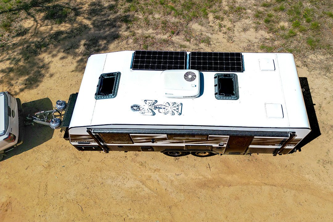

Most caravan air-conditioners are 240V units that require between 1000 and 2000 watts (1–2kW) of power, depending on their size and efficiency. If you’re running it from a 12V battery system, you’ll need an inverter to convert 12V DC power into 240V AC power. To give an idea of the battery draw, a 2000W air-conditioner at full power on a 12V system will need roughly 160–170 amps per hour from your battery bank, especially if the van is already hot inside. Once the van cools down, it will cycle using less power. With a battery bank of 280Ah, and only using up to 50 per cent capacity, your batteries will be flat in about an hour. Even with solar panels replenishing some charge, it’s unlikely you’ll be able to run the air-conditioner for long without additional charging sources.

You’ll need a larger solar array. A 2000W air-conditioner will require at least 800–1200W of solar panels to run efficiently. More solar means recharging your batteries faster and keeping the air-conditioner running longer. Since roof space is limited, you might also consider portable solar panels or solar blankets to boost your charging capability when stationary.
