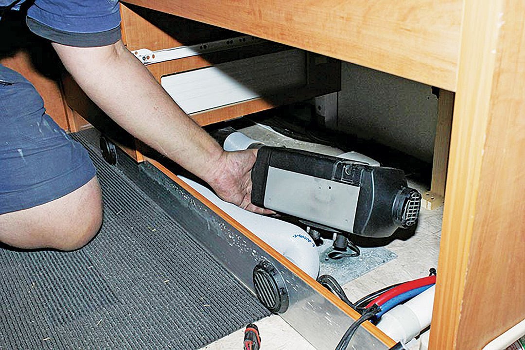

Diesel heaters
Diesel heaters are quite popular because they are one of the simplest systems to use off-grid. We have seen that running an electrical heating/cooling device requires a sophisticated, expensive self-contained electrical system to deliver enough energy to power it. Diesel on the other hand is a very efficient method to store and convert energy. You can buy diesel just about anywhere and you don’t need much of it — diesel heaters typically consume roughly 200ml per hour. Diesel heaters have their own dedicated tank mounted on the outside of the van and they generally have a 10–15L capacity. For easy maths, a 10L tank provides approximately 50 hours run time (10 divided by 0.2 = 50). Plus, it is easy to top up your heater tank with a jerry can of diesel. Given that most tow vehicles run on diesel having a common fuel source is also a bonus.
The principle of how a diesel heater works is pretty simple. The diesel is fed from the external tank to the main unit inside the van containing a burner which converts the diesel into heat energy. Using a fan, air from the room is then circulated through the heater to warm it. The heater unit is generally located under a bed or seating and air is drawn through inlet vents into ducting. The air passes over a heat exchanger warming it and then it continues along ducting and exits the outlet duct/s. Continually passing air through the heater keeps the caravan warm. Diesel heaters do create exhaust fumes and they are piped out to the van exterior.
A common question is do diesel heaters smell? According to Daniel, they can give off an odour, particularly at the exhaust point, but regular servicing will help minimise this. To extend service life the heater burns more cleanly if run on a high setting and preferably not for short periods of time. Servicing is critical because a malfunctioning diesel heater could potentially put carbon monoxide into the room.
