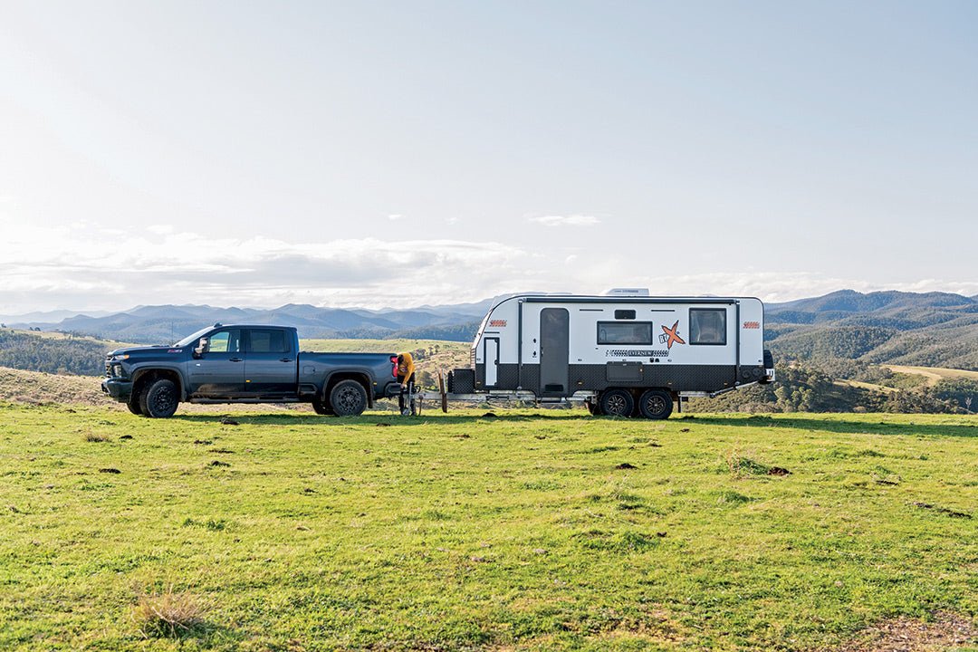

Hitching up an Evernew (Image Cam Inniss)
While hitching up the van might seem like a simple process, there are a lot of things you need to do and check to ensure your van or trailer is correctly hooked on and ready to go. So, to help simplify the process we’ve put together this handy guide and checklist.
