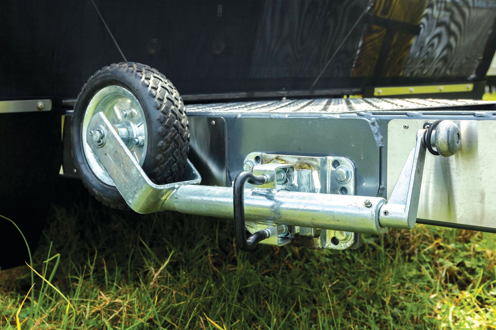

Sure, it’s going on the drawbar/A-frame. However, you need to fit it to an area where it won’t obstruct or adversely affect other fittings and wiring. This goes for the working handle too. Get too close to the gas bottle, stone guard or toolbox and you may not be able to wind the handle at all.
Next is school room geometry. The further you fit the jockey from the hitch itself, the more lift you’ll get at the hitch. This is because the closer you have your jockey wheel to the pivot point (wheel hubs), the greater the angle you create when winding up the unit. While you may not add much, you may be pleased for the extra 10mm when you’re in the scrub. Drawing an appropriate balance takes an attention to detail and a keen eye.
Fitting the unit is actually the easiest part. Some manufacturers weld standard clamp fittings or brackets on the beam for you, while others have removable bolt-on fittings. If you have a standard 50mm clamping jockey wheel, it may be as simple as upgrading to a new one as you’ll be using the same clamp that’s already in place. Alternatively, if you’re bolting on a new one, simply fit the unit with the brackets supplied or two Square U bolts with four nuts. However, don’t forget about those good vibrations. Use lock nuts and consider spring washers and a washer as big as will fit to evenly apply pressure, or even dual bolts. Make short work of it by utilising an impact driver
