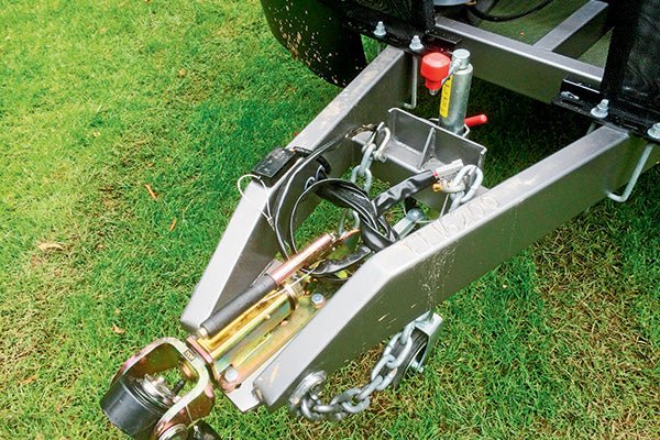

A mechanical park brake, activated via a lever and pin on the A-frame coupling, typically augments the electrically activated system for drum brakes.

The cable-operated handbrake for electric brakes is much simpler again. This lever and cable design activates when the operator applies pressure to the brake shoes by pulling the handbrake lever at the coupling assembly, which pivots and levers forward an adjustable pulley that tensions a cable threaded through the pulley (the earlier, simpler method used was a hook in place of the pulley wheel mechanism). The cable attaches at each end to a pivot point at the brake drum, mechanically exerting pressure on the brake shoes as the cable is tensioned.
This design is very similar to the cable-operated foot-brake system of cars that endured until the 1950s. If you have driven such a vehicle you will never forget the experience. They were often terribly weak brakes, as the pressure exerted on the friction surfaces of the brakes was simply insufficient.
The same problem occurs with cable-operated park brakes; while cheap and simple, they are not brakes you can rely on when parking or when manoeuvring your van on the jockey wheel.
Part of the problem centres on the lack of leverage at the handbrake itself. Ratchet-type handbrakes are better in this regard. They are common with offroad couplings and with European vans, and – if the cable is well adjusted – their better leverage means that you can pull on the handbrake more firmly than the standard lever and pin arrangement. That is, you can exert more leverage and consequently apply more pressure to the brake friction surfaces. This handbrake has the bonus of an easy, push-button release mechanism. Simply put, they are just like a typical floor-mounted vehicle handbrake lever.
Handbrake leverage might be the weakest link in the chain, but it isn’t the only one. The wire cable will stretch and slacken and so needs regular adjustment to be effective as possible and needs to be checked for fraying – which if identified means the cable should be replaced as soon as possible.
