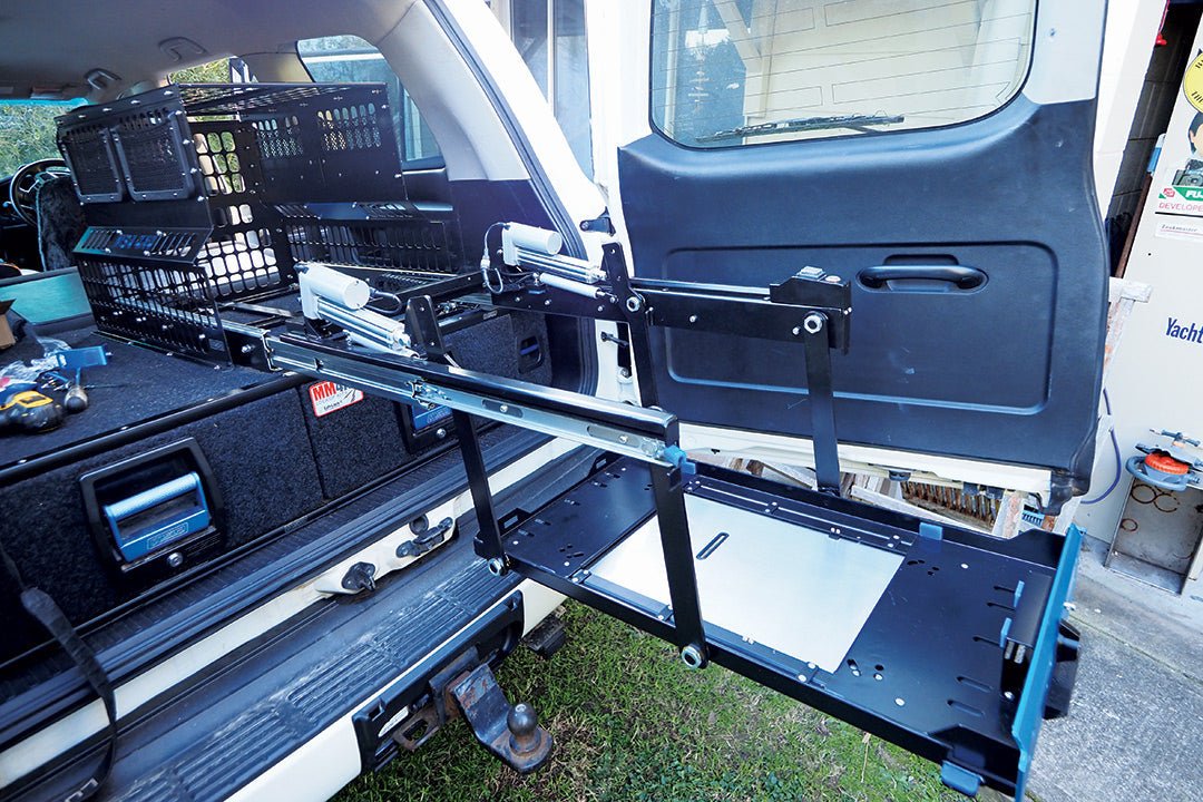

The slide is made to last and weighs 43kg. It’s a bit of an awkward shape, so I had a mate help lift it onto my drawers to avoid damage to me and the LandCruiser’s paintwork. Positioning the slide correctly and leaving room for the fridge barrier took a while because I needed to allow room to open the side storage bins. Once I worked out the correct location, I fixed a couple of screws at the front end to check it opened and dropped without any issues. To test that the location was correct, it first needed power for the slide. Although it was supplied with an Anderson plug power input, I had to make a lead with a matching plug, a 20A fuse and battery terminals to connect to the house battery.
Checking the locationChecking the locationFitting the MSA Power SlideFitting the MSA Power Slide
That complete, I tested the operation and was pleased with the smooth and effortless action. From there, it was simple to screw the slide into place through pre-drilled holes.

With both the fridge slide and barrier installed, I loaded my Dometic chest fridge onto the slide and strapped it down with the supplied friction straps. Using the two-touch control, the fridge dropped 30cm and slid out smoothly, making it quick and easy to access the fridge’s contents. Much better than crawling into the back of the car and rummaging through a pile of stuff for a cold beer.
The DS40 MSA Power Slide™ with Table has an RRP of $1784. The FBDS40N Drop Slide Fridge Barrier is $440. Both are available on the MSA 4X4 Accessories website.
Two-touch control to operate the slideTwo-touch control to operate the slideThe MSA Power Slide with Table and Drop Slide Fridge BarrierThe MSA Power Slide with Table and Drop Slide Fridge Barrier
