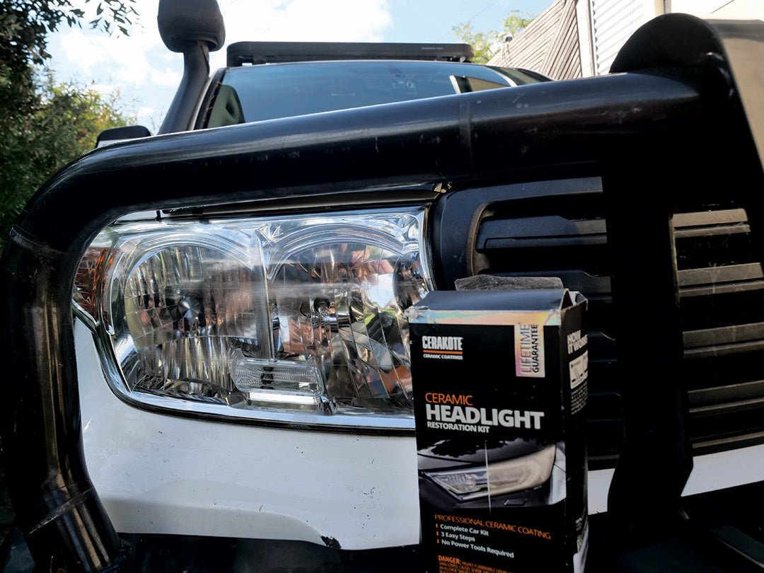

My LandCruiser headlights were a bit cloudyMy LandCruiser headlights were a bit cloudy

The results were impressive. The lights looked as good as new, making the car look much better. It’s always satisfying when a product performs as expected. I was impressed with the result, and I look forward to the restoration being permanent because the kit comes with a lifetime guarantee.
As good as newAs good as new
