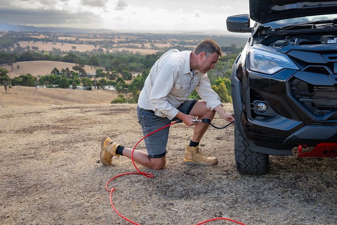

Saber claims the SBR-TAC1 can inflate a 265/70R17 tyre from 0 to 40 PSI in two minutes and 15 seconds. Out in the field, we dropped the D-MAX’s tyres down to 10 PSI, then timed inflations back to 40 PSI.
Our results? Around 1.45 minutes per tyre. Even when pumping up all four tyres, it only took about eight minutes to eight minutes and 30 seconds in total — impressive for a portable 12V setup.
But we didn’t stop there. Back at the office, we ran a 30-minute torture test, continuously inflating 265/70R17 tyres from 10 to 40 PSI on the boss’s Toyota LandCruiser Prado. The Saber smashed through 15 tyres without skipping a beat, maintaining an average time of around two minutes per tyre by the end of the session.
No overheating, no slowing down — just relentless, unwavering performance.
