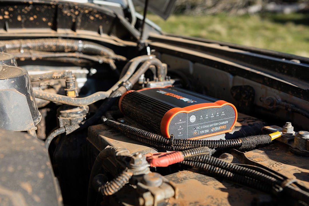

There are many parts of an off-grid caravan power system, but you don’t need all these to make a basic package of electronics. I suggest that the first step is a quality DC-DC charger that has MPPT solar capabilities. This kind of charger will mean you have solar power when driving or stationary and it will also allow you to charge devices and batteries from the alternator in your tow vehicle.
Many DC-DC chargers blend both sources of power and offer an increased power output when only utilising one source. A charger designed for under-bonnet use is the best choice, as it is likely to have higher quality internal parts that will last longer because the unit is designed to withstand extreme heat.
Products such as a BMPRO ProSmart 40 is an example of a unit built for this purpose. I suggest you don’t install any charger in the engine bay unless it clearly states it has been designed for that purpose.
Always install the charger with recommended fusing and cable thickness suitable to carry heavier amperage. For wiring to a van, use an Anderson connector at the rear of your car rather than trying to wire it into a trailer plug which isn’t suitable for a thicker gauge wire.
