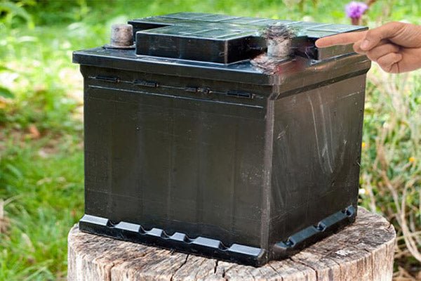

The ‘last resort’ hot ash method
Light a fire and let it burn down to hot ashes. Remove the filler caps from the top of the battery and place the battery in the hot ash – don’t let it catch fire! After a good warm up reinstall the battery, cross your fingers and hit the start button.
