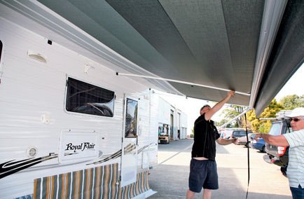

01 The awning – in this case a Dometic A&E – should be fully opened and tensioned up using the roof rafters, which are fitted by using plastic clips on the van and spigot holes in the roller tube of the awning.
02 It’s helpful to lay the walls out before fitting. Here the roof rafter is fitted into the gable sleeve of the end wall.
03 Attach the end walls to the caravan by sliding the wall edge up the sail track. Applying silicone spray to the sail track makes this process a bit easier.
04 With the ends in position, the roof rafters can be tensioned up and the walls attached to the draught sheet.
05 Like the end walls, the side walls are laid out before being run along the slot in the roller tube. Again, silicone spray can be used to ease things along. (Although side walls are usually a single piece, in this case they were split in two to make things easier for the owner.)
06 Once all walls are in position, they are zipped together at the corners (and the middle in this case).
07 All poles can be fitted into the roller tube holes and velcro-strapped to the walls.
08 The doors can now be zipped in position as required. One tip from the Kakadu team is to roll the doors inward – this keeps things neat and prevents rain from gathering in the externally rolled door.
09 Once you have set out the wall mudflaps and laid out the floor matting above them, connect the end walls to the awning with the “stayputs”.
10 At a campsite, you would now be pegging out the annexe walls – but this proved a little hard to do on the concrete.
