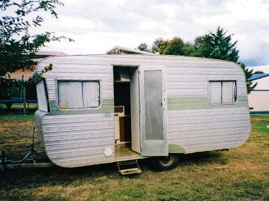

A closer inspection immediately revealed that one of the corners of the timber frame was suffering moisture damage, but the extent of the problem didn’t reveal itself until Rob had a really good look.
“After I saw the moisture in that one corner, I removed the aluminium and the whole lot just crumbled,” he said. “I ended up finding out there was only one good corner on the whole van.”
The water damage meant the frame had to be built-up again. So Rob went to work and ultimately stripped the whole thing back before using new pine wood to reinforce Betsy’s old bones.
“I am not the kind of person who likes to do things by half,” he explained. “That’s why I ended up stripping it all the way down and building it back up.”
