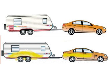

FRONT LOADING
The weight at the front wheels of the tow vehicle is especially important. Most people would understand that a large load at the back of the car can create a see-saw effect, and inadequate front weight adversely affects steering and braking because the wheels cannot grip as well as they should.
A simple way to check front-end load is to carefully measure the distance from the ground to the top of the front wheel arch when the tow vehicle is unloaded and not connected to your van. Then connect the (fully loaded) van and measure the wheel arch height again. If it’s the same, the tow vehicle is correctly set up, but if the height is greater you need to adjust the weight distribution gear to restore the ground-to-wheel arch measurement to the same height as when unladen.
