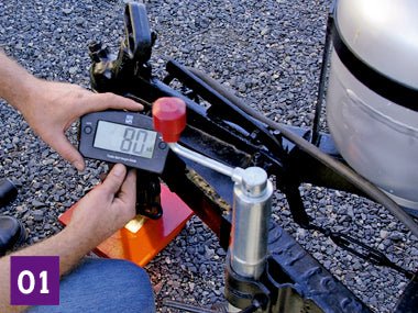

01 To establish what kind of WDH is needed, first establish the nose weight of the caravan. Then select the WDH that will accommodate that load range. For an accurate assessment, weigh the van laden.
