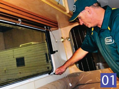

01 Using a sharp knife, cut away any excess silicone around the edges of the window. This is done both inside and outside the van.
