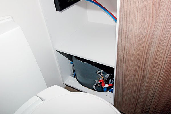

1. In this case, the HWS was built into a lower cabinet in the corner of the bathroom. The toilet was removed, giving much better access. If this was not possible or if there were other cabinets impeding access, cutting out the cabinet shelf would have been the only option.
2. The toilet cassette was removed to gain access to the screws holding the toilet down and these screws were removed. The toilet could then be removed from the van.
