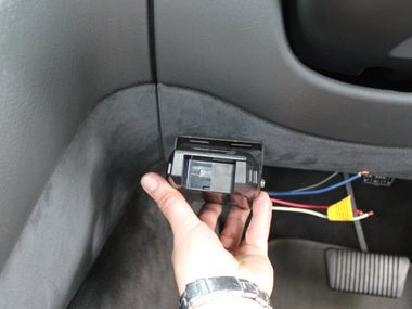

Not long after the towbar was sorted, I thought I’d better swap over the electric brake controller I had in my 1982 WB Statesman (which has been retired from road duties pending a restoration), and that was only a couple of years old. Add to the budget a Tekonsha Voyager controller, worth around $50, and another $50 spent on wiring, connectors and fuses (one resettable 25A fuse and an inline 15A fuse).
The brake controller fitment was a pretty easy process, but to do the job neatly – plus an extra visit to the shops to get parts I forgot the first time – spun the procedure out to the better part of a day. I know there are various pros and cons of using crimped 12V connectors versus soldering them, so I used the connectors with a dab of solder as insurance. Solder alone can crack if vibration or movement occurs, but some crimped connectors can also corrode or simply not grip the wire enough and cause intermittent connections, or drop off altogether. I strip the plastic insulator off the connector, bend the metal tangs so that they grip the wire and drop some solder onto the tangs/wire. Add some heatshrink to insulate the connection, and that’s the job done.
