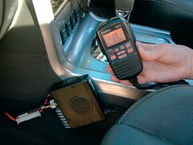

That poses the question of whether to buy a cheaper handheld radio or a more substantial, in terms of size and cost, vehicle-mounted device.
Mark’s reply is succinct: “A handheld is a waste of time in a vehicle,” he said. “You can use a handheld when you are trying to park your caravan and you’ve got someone outside steering you in.
“For in the vehicle, you should have an in-vehicle unit.”
Mark said using a handheld radio in the vehicle meant having to buy an extra speaker mic, which then created the added problem of transmitting from inside.
“Then you really need an external antenna.”
With that in mind, Mark recommends buying an inexpensive in-vehicle radio, such as a GME, with a decent 6db elevated-feed antenna for around $500.
More expensive models provide coverage as well as additional features, including GPS, emergency alarm, data and group or radio-to-radio communications.
These are first-class units, but the price rises accordingly to around $900 for a portable model.
“You have to look at where you are using the radio,” Mark said. “If 99.9 per cent of the time it’s in the vehicle, then that’s where you put your money.”
