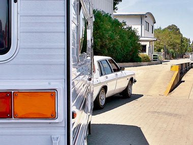

FIND A BRIDGE
A web search will find your nearest public weighbridge. Most weighbridges are at commercial premises frequented by the sort of vehicles needing to measure payload. If you call the people at the weighbridge and ask when their quiet periods are, explaining that you want to weigh your caravan and vehicle, most operators should understand what you want to do.
If you have time, it is a good idea to visit the weighbridge twice. Take your rig unladen the first time, because this gives you a better baseline to more accurately calculate payload. Return the second time with the van loaded and ready to go on tour. Dealer-fitted accessories are usually not included on the manufacturer’s plate.
Make sure the gas cylinder(s), water tank(s) and fuel tank contain about the same amount of liquids as the next time you do a full payload weight check. Every litre of gas, water or fuel weighs approximately 1kg and may alter your readings.
STRIKING A BALANCE
Weighbridges vary in sophistication – many have one large pad, while others have a number of smaller ones. The advantage of multiple pads is you don’t need to move the rig off the weighbridge to ascertain specific axle weights.
