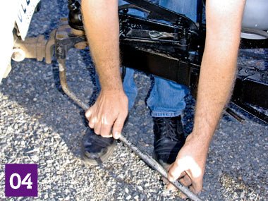

04 Fit the load leveller rod upwards into the hole in the cast iron head.
