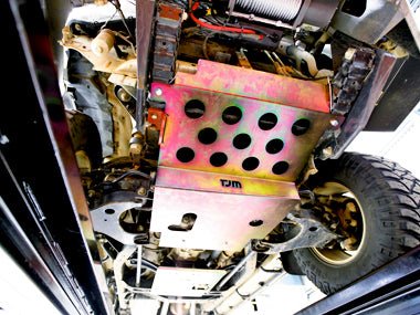

However, if you know you will need the best protection – or simply feel that it’s better to be safe than sorry – you’ll find most aftermarket bash plates start at 3mm in thickness. That’s pretty solid – and also heavy. We all know that just about everything we do to our vehicles involves compromise, and in this case it’s weight.
Unfortunately, you won’t find the weight of aftermarket bash plates quoted in the brochures, but it’s not unusual to end up bolting 20kg under your car, and a large vehicle with full protection may end up with an extra 50kg or more of metal underneath. This all eats into your cargo capacity (and GCM).
LOCATION
Weight is not the only fact to consider. Bash plates can affect the flow of air required for cooling your engine or transmission, so make sure ventilation holes are included if they will block airflow to coolers on your vehicle. Avoid protection plates that cover sump plugs, oil filters and anything else your mechanic has to reach when servicing your 4WD, because otherwise you’ll be up for extra labour charges as the mechanic removes and replaces the plates.
Well-designed plates will also clear standard tow hooks and recovery points, although you can’t expect them to allow for other aftermarket add-ons, and if you find a conflict you’ll have to sort out your own solution. Grass, mud and stones can also build up between the plates and the vehicle: too much dried grass will lead to a major fire hazard; stones jammed in there may rub through the parts you’re trying to protect; and mud can create overheating problems, as well as adding fuel-and power-sapping weight. It’s a hassle, but get under and clean out everything above the plates now and then.
Regularly check that the retaining bolts are still done up tight, too. Most plate designs leave some of the bolt heads exposed, and they’ll inevitably be damaged, so it’s worth replacing them before they’re so bad that a socket won’t grip any more. Either that, or you’ll have to grind off the damaged heads and wrestle the bolt shaft out.
