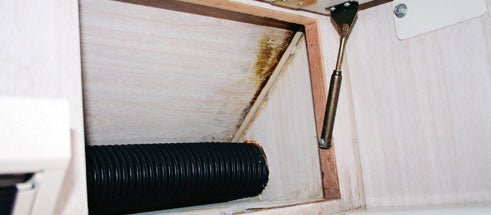

The leak was coming through at the rear left corner wall of the pop-top, and water was leaking through at a fair rate. The first job was to raise the roof so we could see if there was any sealant missing on the join around the roof and its base. Everything seemed okay, so we decided the easiest thing to do was remove the side moulding to inspect for leaks.

1 It’s clear the leak had been coming through the cupboard for a while.
