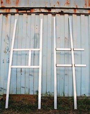

An air-conditioner like this Dometic has most of the fittings required with the unit, but you will also need silastic sealant, a support bracket (if you don’t trust your welding skills, companies like Sydney’s Barnes Caravans can sell you a pre-fabricated unit), some timber for the roof cavity support, wiring to the appropriate amperage (10A here), a plug and connectors and, in this case, 12V wiring to re-route the roof downlights. Some self-tapping screws will also be required.

01 Two supports – the one on the left with welds ground smooth.
