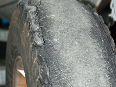

We had done a couple of highway trips with our 5.65m trailerboat and, on two consecutive trips, a tyre had failed (peeled the tread clean off) in about the same spot on our journey.
When I visited my tyre retailer for
the second replacement in as many months, I asked why.
“How old are your tyres?” was his immediate response.
I thought for a moment and declared them to be 6 to 7 years old. “That’s your problem,” he said.
Tyres generally have a reliable life of about 5 to 6 years.
“You can either change them all now, or change them one at a time, but eventually they will all fail,” the retailer continued, inducing a sharp pain in my hip pocket nerve.
I bit the bullet and changed all five tyres, even though they looked almost brand new.
(Few people actually wear out boat trailer tyres.) My decision was justified when the tyre fitter who was fitting the new tyres noticed a bubble in one of the old tyres.
It was ready to shed its tread on our next fishing trip.
