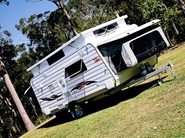

If you take such weights into consideration, your towing options are a bit limited – something like Jayco’s pop-top Starcraft which is quite small, or one of the European vans, e.g., Adria’s 6m (19ft 8in) 542PK. In some cases you might have to go without an on-board bathroom but most Adrias have one, as does a locally built Majestic Knight. That was quite a surprise with an ATM of 1929kg.
Other suitable towing prospects in the pop-top and fold-out range include Jayco’s Expanda models as well as its camper trailers. WA-based Coromal has its Pioneer pop-tops and Silhouette campers, while Windsor has its Rapid fold-out range as well as smaller Genesis caravans. In Qld, Gary Kratzmann sells his Franklin Sonic pop-top/fold-outs.
Full lightweight caravans are a little rarer but more are appearing from companies like Jurgens Australia, with its Skygazer line-up. Many caravan manufacturers do at least have smaller vans (often without a bathroom) that can be towed by a 2WD sedan.
