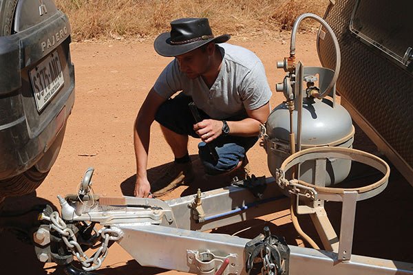

A ball coupling does not need much maintenance, but it is important to cover off two elements. Firstly, the coupling cavity should be lightly greased so that it can swivel freely and avoid excessive wear on the towball and coupling. Secondly, any excessive slack in the coupling when it is secured on the ball should be taken up with the adjusting bolt.
The friction type of coupling should never be lubricated and the towball must be secured to the tongue with a locking plate so that it does not swivel. A standard towball cannot be used either, as it lacks the flats on the ball plate to key into the locking plate. Eventually the friction pads will wear beyond their specified service thickness and will require replacement.
