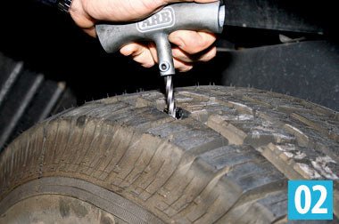

Get the probe tool to check that the puncture hole is clear of debris (pic 2). Then wipe some lube on the probe tool and wipe it in the puncture area, and keep the dirty jokes to yourself (pic 3). Then, with a plug threaded into the insertion tool (pic 4), push the plug into the puncture site with about half the length you’ve inserted remaining visible (pic 5). Cut off excess plug material with a razor blade if it’s hanging out well past the tread blocks. Then pull the T-piece handle up, releasing the plug, and take out the insertion tool (pic 6). Inflate the tyre to maximum tyre placard pressure (pic 7).
