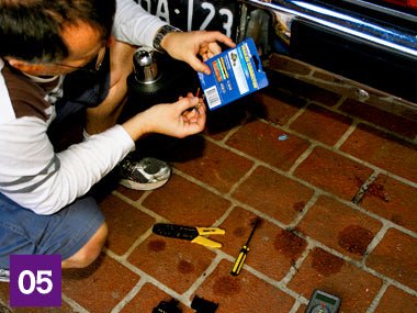

05 Unscrew wires from the old plug, noting that the wire insulation colour corresponds with the position on the plug as noted with the new plug.
