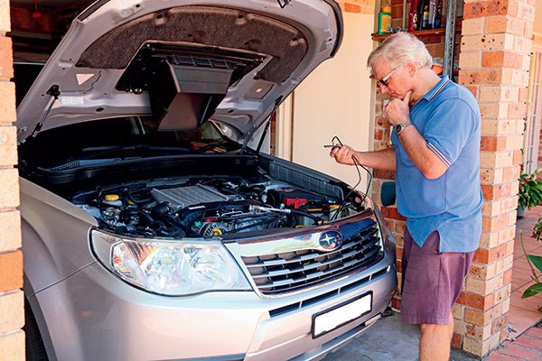

This is a fairly simple job, so all you’ll need are pliers (standard and long nose), screwdrivers, multimeter or 12V tester, power drill and drill bits, tape measure, electrical tape and a bit of stiff wire, aka an unbent coat hanger for pulling wires through awkward to get at places. A crimping tool is also useful for the lugs, otherwise the pliers will do. A general knowledge of vehicle 12V power systems is useful, too.
MOUNTING THE LIGHTS
Having chosen the appropriate location, it’s a case of drilling holes and fitting the light brackets. In this case, the brackets can be fitted first with the actual lights just clipping in. The Hella bracket allows for easy adjustment of the angle of the light.
RUNNING THE WIRING
Whilst mounting the lights, have a think about where the wiring is going. In my case, the lights had the wiring already connected – it was insulated two core (positive and negative) with a PVC outer sheath. The light cables need to be run to a relay which in turn needs to be connected to both a headlight connection and a fused 12V supply. A final connection is from the ignition supply to the relay. All that ensures the DRLs will operate whenever the ignition is turned on but not when the headlights are being used. Ideally, the relay should be near both the battery and the headlight it’s connected to. A little tip here is to make sure the wiring does not come into contact with anything hot like the radiator which is close by nor run through metal holes where it can be chaffed.
