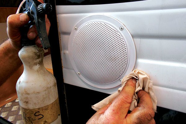

STEP 12
Wipe off silastic with a clean rag and turps.
