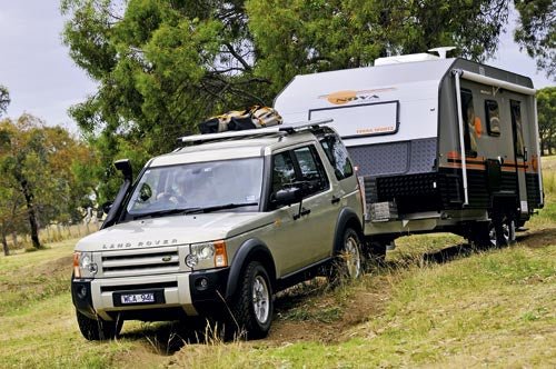

Then there are the hybrid vans, designed for rough-road travel, which can come in as light as 1.5t. So, although it’s overkill for hauling our personal 14ft Outback-spec Jayco Expanda on holidays, I have equipped my 2008 Land Rover Discovery 3 TDV6 to handle whatever is thrown at it.
THE ‘MITCH HITCH’
The starting point with the Disco was to improve its towing ability, but with a 3500kg braked capability and 440Nm available from its 2.7L turbodiesel engine, grunt and strength were never in question. It was the low-slung towbar hitch that earned it the well-deserved nickname of ‘the plough’.
Sitting too low, it greatly reduces the vehicle’s departure angle but, even more incredible for a vehicle designed to tow offroad, you can’t remove the under-floor spare wheel on a D3 with the standard hitch fitted, so you can imagine the hassle if you get a flat tyre with a heavy van hitched up.
The spare wheel issue has been resolved with a revised factory hitch on the Discovery 4, but it will cost you close to $700 if you want to update your D3, and it will still sit too low.
Engineer Aaron Mitchell’s better solution was to design a steel 3.5t-rated and ADR-compliant hitch that utilises the wedge-shaped recess of the factory hitch and bolts to the D3’s hitch base and bumper-mounted towing eye.
It took nine months and several hundred hours to develop, but the result is a bumper bar-level hitch that weighs just 8kg and sits 200mm higher than a factory D3 equivalent (150mm higher than a D4 hitch) to ensure your offroad trailer tows level.
It is also stronger, easier to use, does not impede removal of the spare wheel and only reduces the vehicle’s departure angle by 1° compared with the factory unit and, for $695, it’s a no-brainer if you are planning to tow an offroad camper or caravan.
Melbourne Land Rover specialist Ritter Automotive, which has fitted many of the 700 ‘Mitch Hitches’ currently in service around Australia, says the job takes up to two hours, including the fiddly task of rotating the rear bumper parking sensors so they don’t go hysterical when they see the protruding hitch.
When towing conventional on-road caravans, I simply fit an adjustable drop-hitch, which replicates the height of the standard D3 hitch.
