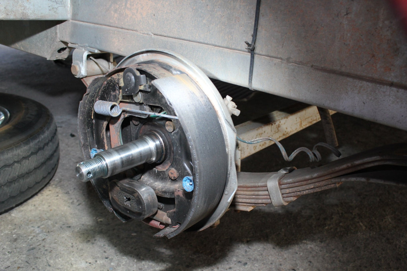

ELECTRIC OVER DRUM
This design uses a magnet within the drum that, once energised, pushes out the brake shoes onto the drum. The brakes are activated by current sent through the trailer plug from the tow vehicle, activated and apportioned by the electric brake controller.
This system can work very well, but it needs all the components to be in prime condition and properly adjusted.
