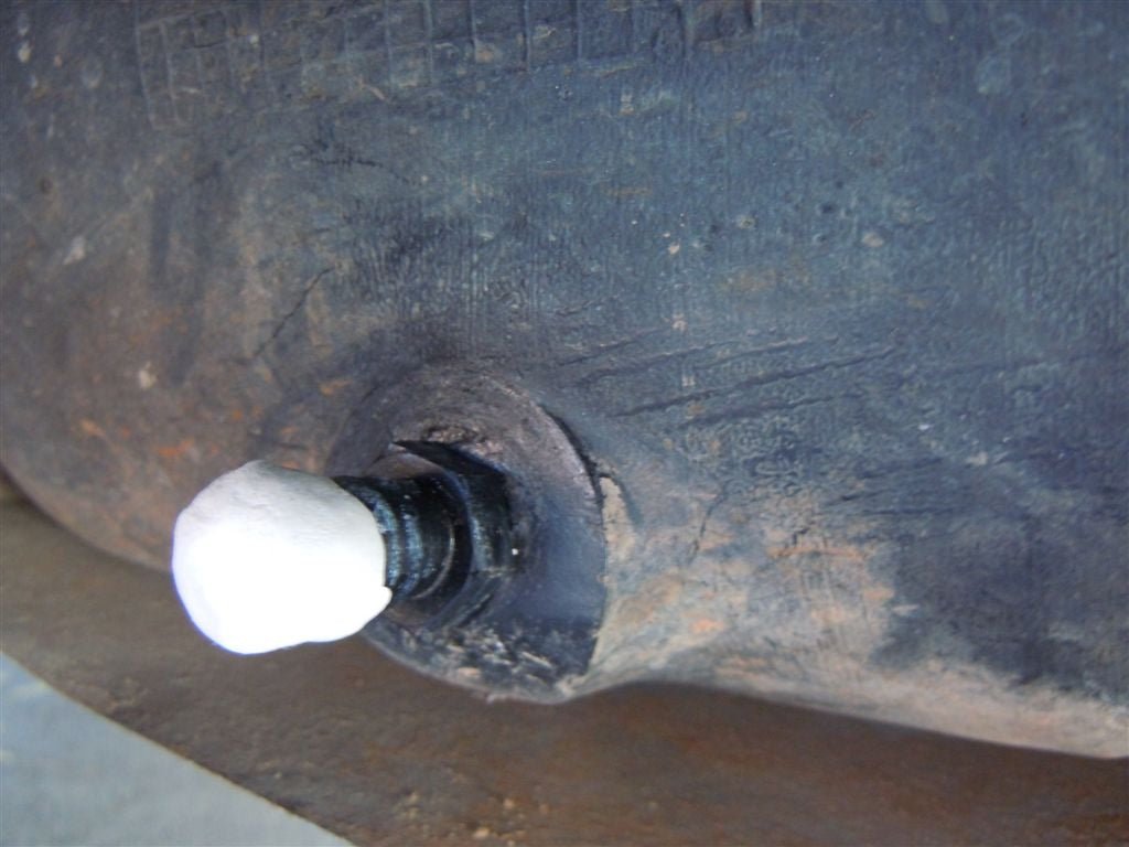

THE BROKEN WATER TAP AND RUBBER HOSE
Some time ago, after we’d travelled on a lot of dirt roads, we found the water tap on the bottom of our water had broken due to flying stones. This is a common problem. I was able to apply some ‘Leak Bog’ to the broken fitting, and that held water in the tank until I could buy a new fitting. However, I have now discarded the tap and just have a plain screw-in plug that I undo when I want to release water from the tank at the end of each trip, or to flush the tank. Problem solved, and this small plug has never been damaged, as it is protected by the sheeting around the tank.
