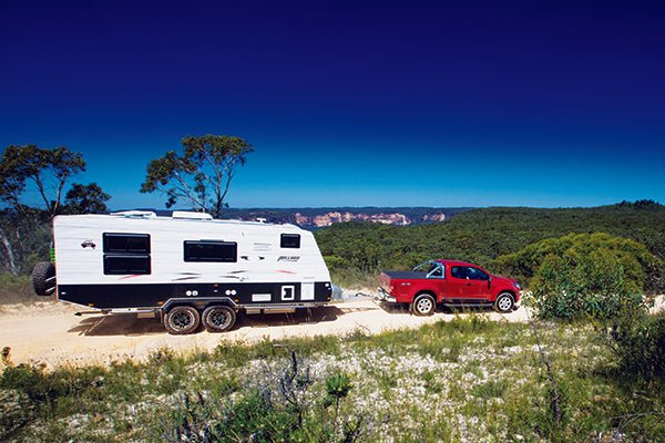

TOWING THE TWO
The Millard is a heavy caravan, no doubt about it. With a Tare weight of nearly 2900kg, it was well within our Holden Colorado’s towing capacity (3500kg) as we towed it empty but, on slippery surfaces, you sure knew about it.
The Millard was assertive about where it wanted to go, and it wasn’t always where the Colorado driver intended.
Part of this can be put down to the fact that we were towing with utes. These utes are designed to take a substantial payload in their trays so, with empty trays, you can expect the weight over the rear axle to be less than ideal.
Also, these tow vehicles were shod with standard highway-terrain tyres. With suitable all-terrain or mud-terrain tyres, the grip on slippery offroad surfaces would improve dramatically.
The Avida’s lighter footprint was immediately apparent: it towed with much less desire to push the tow vehicle around.
The Millard was heavier than the Avida by nearly 800kg. Granted, it did have a large number of extras fitted to it but that weight is definitely a factor for consideration. And although both our tow vehicles had the necessary maximum towing mass for both vans, there’s no doubt the Millard van was much heavier than both vehicles and, on gravel roads, it was a little disconcerting as it pushed the rear of the tow vehicle around. Leaving 4WD constantly engaged was mandatory, but we reckon that having a tow vehicle heavier than the caravan is an asset. In this case, the Millard is definitely in LandCruiser 200 Series territory.
