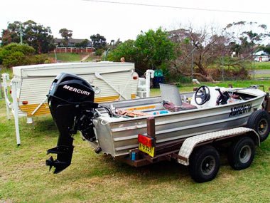

IT WASN'T LONG before Gus had his light bulb moment: “Why not put the van on top of the boat and pull the tinnie out when we camp?” He was soon drawing up plans and designs to get his project off the ground.
Eventually Gus bought a second hand trailer, which he rehashed to fit a 12ft V-nosed tinnie. He then bought a wind-up campervan and some electric jacks. Using his backyard as his workshop, Gus put the electric-lift campervan on top of the trailer and the Guso Trava Boat was born.
“When we pull up at a camping spot, we extend the jacks and lift the camper up, which separates from the boat trailer. We drive the boat and trailer away, then let the van down to ground level,” Gus explained.
“It actually works better than I expected. We have travelled everywhere with it and often have a very curious audience of campers. And my back has had no problems at all.”
