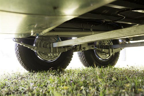

1. IS YOUR CARAVAN VULNERABLE?
Inspect the underside of your caravan for areas of vulnerability. Even caravans marketed as ‘offroad’ vans may have exposed grey water plumbing or unprotected wiring. Be sure that wires connecting to the electric brakes are protected, lest a flying rock sever the thing wire and leave your van without brakes.
If you’re concerned that any PVC will be potentially shot-peened to pieces by flying gravel, why not ‘lag’ it with offcuts of carpet, securing it in place with cable ties?
