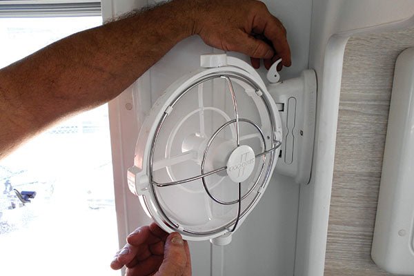

With the wiring completed, it’s time to install the fan to the mounting plate.
Securely fasten the fan to the mounting plate.
With the fan secured to the mounting plate, swivel the fan to the desired position and you’re ready to use it.
