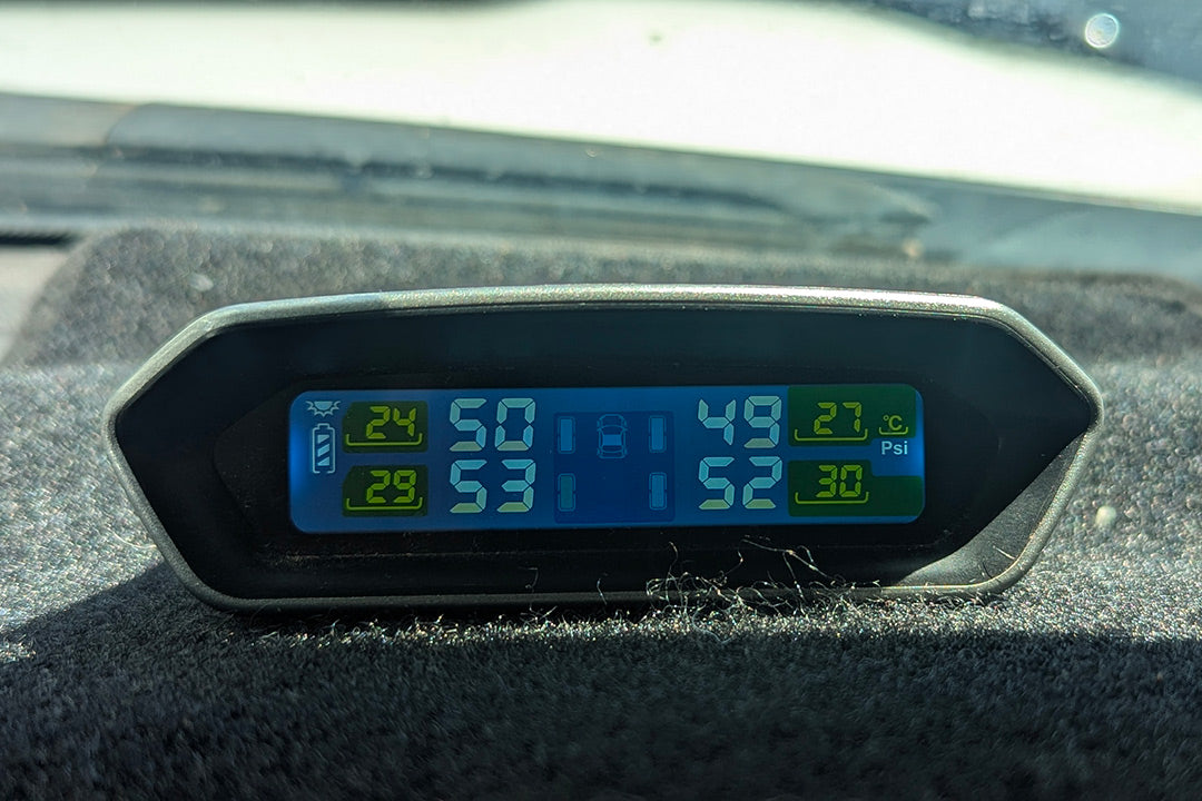

Fitting was straightforward, and the instruction manual is clear. After charging the monitor in the sun for a couple of hours, the battery level was full, so I screwed the sensors into their marked positions at each wheel. The pressure and temperature appeared on the monitor screen for the relevant tyre almost immediately.
Since we frequently air down the tyres when heading on uneven terrain and use higher tyre pressures when towing, I checked the alarm’s range to suit these conditions and found it quite straightforward. Because the alarms operate in pairs at each axle, rather than on individual tyres, it was quick to set up.
Alarms detect both fast and slow pressure loss and temperature rises, so if you get a puncture, you can stop driving before the tyre deflates completely and is damaged. The sensors are IP67 rated, making them suitable for water crossings and dusty conditions. The Promata TPMS will work on up to 10 tyres, allowing it to monitor a twin-axle van and two spares.

We’ve driven for the past two weeks with the Promata Mata2E tyre pressure monitors installed, and they’ve been accurate in tracking pressures. I’ve noticed that the tyre pressure stays within the range, increasing by about four PSI as we drive.
I feel the screen isn’t as bright as some systems I’ve used, and I’m told this is to save power and extend battery and LED life. The manual recommends not leaving the monitor in direct sunlight and placing it closer to the A-pillar to improve performance. Like all LED screens, it’s impossible to see anything with polaroid sunnies.
