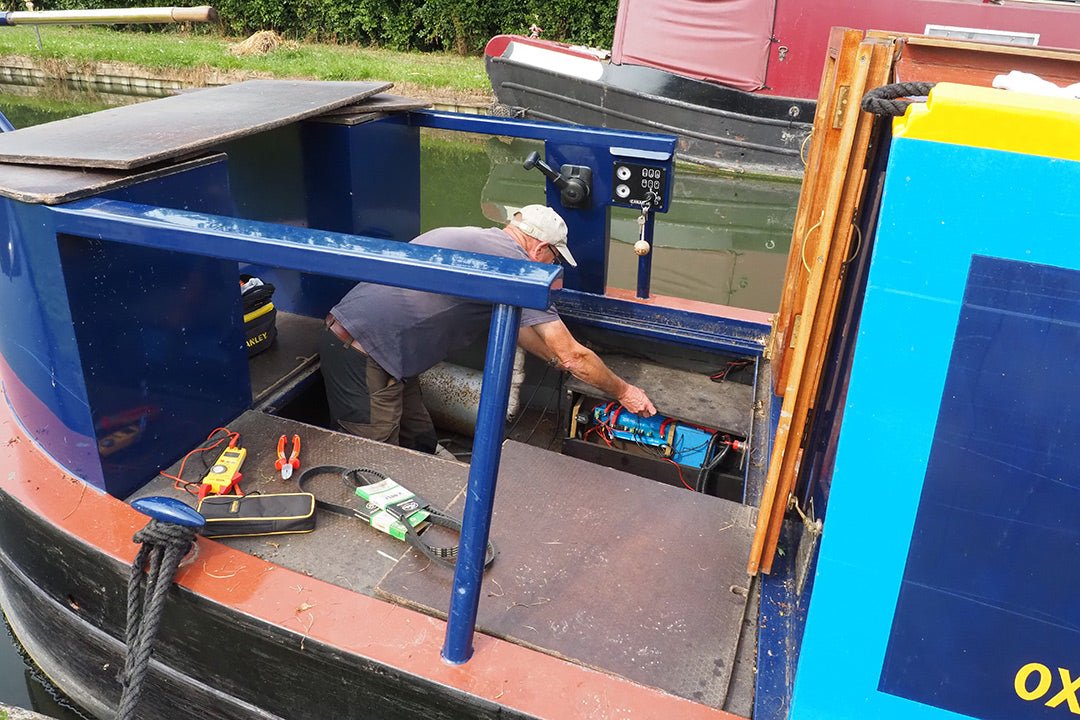

One morning, just recently, I stumbled out of bed to make a morning cuppa, but the water pump wasn’t delivering. Initially, I thought the water tank was empty. However, further investigation revealed that the Victron 200Ah lithium battery had reached its cutoff voltage of 11.2V and switched off. Why this situation had arisen was highly puzzling, given that we’d been running the engine all the previous afternoon and would only be using the LED lights, a 90L compressor fridge and the inverter to charge a few devices overnight.
Dealing with power problems on the water
Although this might be a familiar problem to some, did I mention that I wasn’t travelling in an RV? This particular power issue happened on our rental canal narrowboat, which we had hired to explore the Oxford Canal in England. Running the engine didn’t recharge anything. When the service tech arrived, he discovered that the cable connecting the house battery to the alternator had come adrift. A few connections later, and 30 minutes of running the engine re-energised the battery enough to prove things were functional again. Following some good advice, I installed the Victron app (VictronConnect) on my iPhone, allowing me to easily monitor the battery’s status without a multi-meter and enjoy a worry-free time on the canal.
