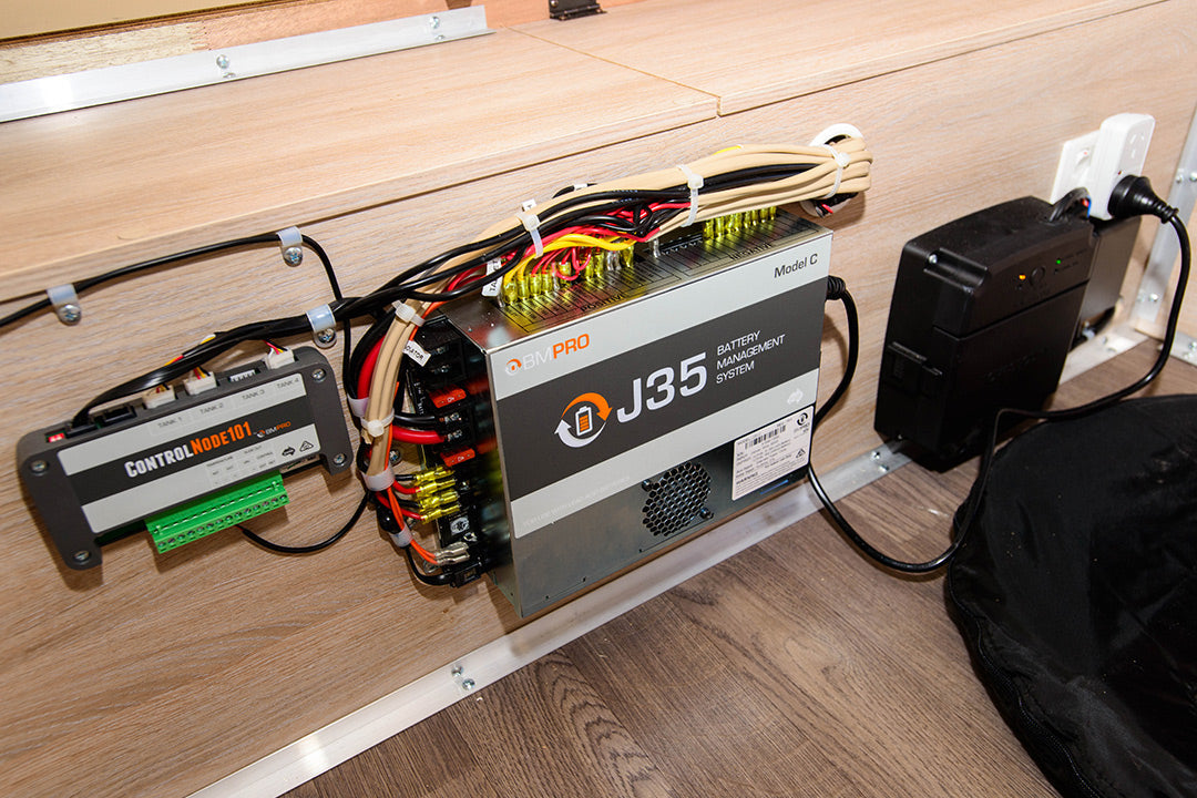

My wife and I own a 2019 Jayco Silverline caravan which is fitted with a BMPRO J35, model C. With your experience with BMPRO I am hoping you can advise me of which direction to go.
I installed two lithium batteries from iTechworld before a recent trip to Western Australia. I was told that the batteries were a drop-in swap and that my charging system did not need to be changed. I now know that is not correct. The BMPRO model C does not recognise the lithium batteries, and it also has no capacity to receive charge from the car.
I have rectified this by fitting a REDARC DC-DC charger to my van. Because the lithium batteries do not show a voltage drop until they are nearly dead flat, the solar panels also did not provide charge. I have been advised that a model D will work and recognise and charge the lithium batteries? I would also like to know if the Bluetooth node 102 is compatible to monitor the battery status? Thank you in advance for your expertise.

It is possible to upgrade your J35C to the capabilities of a D version through the BMPRO upgrade program. Check out the website for more details. Your current unit needs to be removed and then sent away for an upgrade. As part of this, it receives additional warranty. The returned unit will then be set as lithium ready, and you will need to utilise the settings through the screen or app to ensure you set the right battery capacity so that it can effectively monitor battery state of charge.
It’s great that you have upgraded your DC-DC capabilities as the J35 series can only provide a trickle charge through its DC-DC input and can’t compete with the newer vehicle smart chargers to boost voltage and charge a battery properly on the go. I suggest that you install the BC300 external shunt to ensure that all current that goes into the battery directly from the DC charger is captured in the charging algorithm. In addition, the DC charger should be providing MPPT solar charging to keep the batteries topped up. If not, you can always wire the solar panels into the integrated BMPRO system which has its own proprietary charging algorithms.
