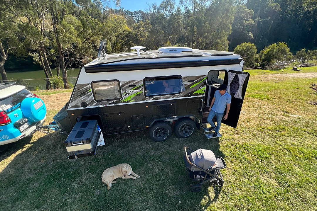

Gree air conditioner has a sleek profile
While from a technical perspective you could run the AC from the battery system, it would pose such a demand on power requirements that you would arrive at your next destination with no power supply for overnight requirements. Most travellers rely upon the DC charge available from their vehicle combined with solar power stored during the driving time to recharge their systems. By way of example some RV owners are using the opportunity to install lithium batteries and inverters to run their air conditioners to take the heat out of the van at the end of a hot day (when stationary and camped). The problem with this is battery depletion and lack of opportunity to recharge.
The standard RV air conditioners supplied in caravans are also not fit for purpose. As a unit they are designed to be used while stationary, only run off 240V with no direct 12V solutions (for example, just the fan) and the filtration systems are not designed to handle such loads — you would be constantly cleaning this out and its fair to suggest that fine red bulldust we all despise so much would become a permanent feature of the AC.
