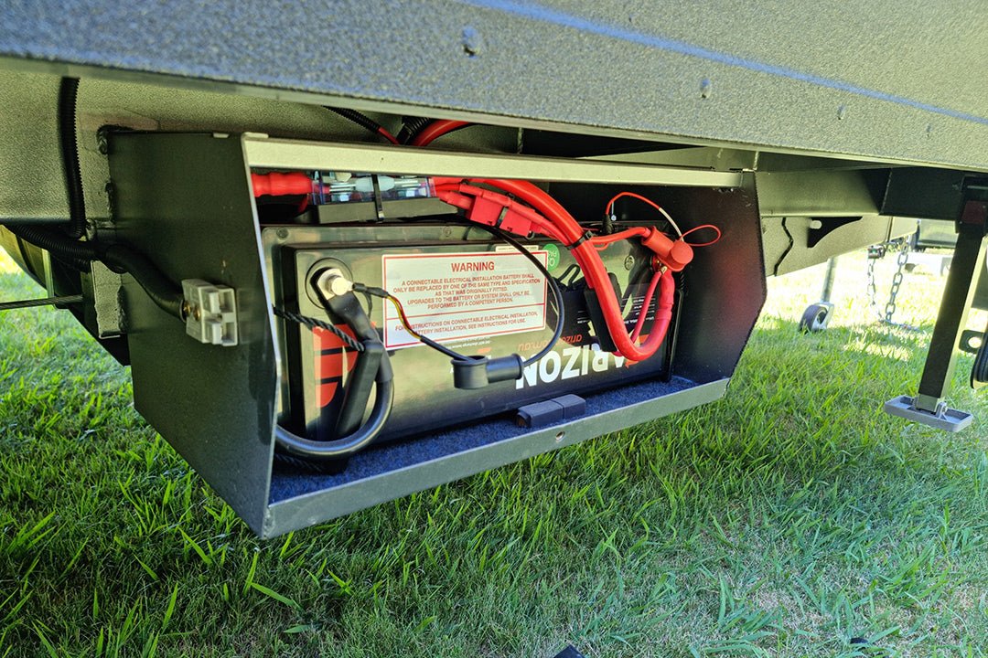

Battery health inspection
The heart of your caravan’s electrical system is its battery. Start by verifying that the battery can be fully charged. If you can, it is worthwhile checking the state of health of the battery — especially if it’s a bit old.
Examine the battery for signs of wear or damage, such as cracks or swelling. These can indicate serious issues that might require a battery replacement. Next, check the battery terminals for corrosion. This is a common issue that can impede the efficiency of your battery. Clean any corrosion using a solution of baking soda and water and secure all connections to ensure they are tight and clean. Applying a corrosion-resistant spray can also help prolong the life of the terminals. As many installations are now outside the caravan and on the side of the chassis, ensure the terminals and relevant areas are in good condition and not fouled with road debris.
