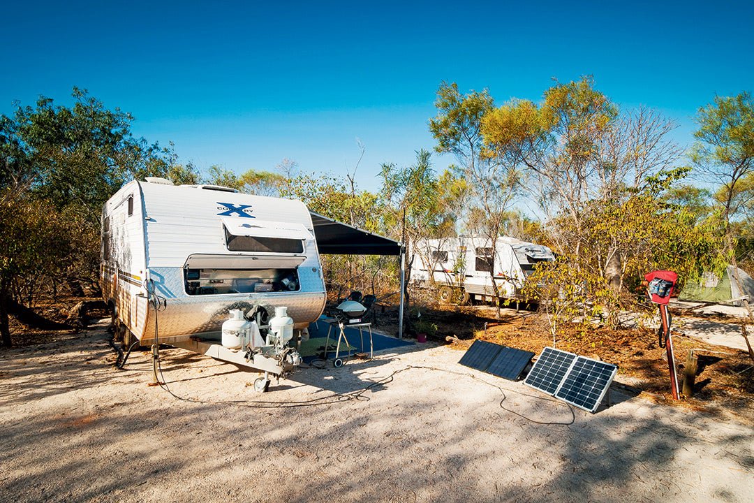

While solar blankets typically aren’t as efficient per watt as fixed rooftop panels, they do have a major advantage: portability.
With a solar blanket, you can position it wherever the sun is shining best. This is especially useful in shaded campsites or during early morning and late afternoon when the angle of the sun is less optimal for roof panels. You can even move the blanket throughout the day to track the sun and maximise exposure — something roof panels simply can’t do.
Additionally, when parked under trees or awnings, a solar blanket allows you to make use of that clear patch of sunlight a few metres away, keeping your battery topped up while enjoying a cooler campsite.
