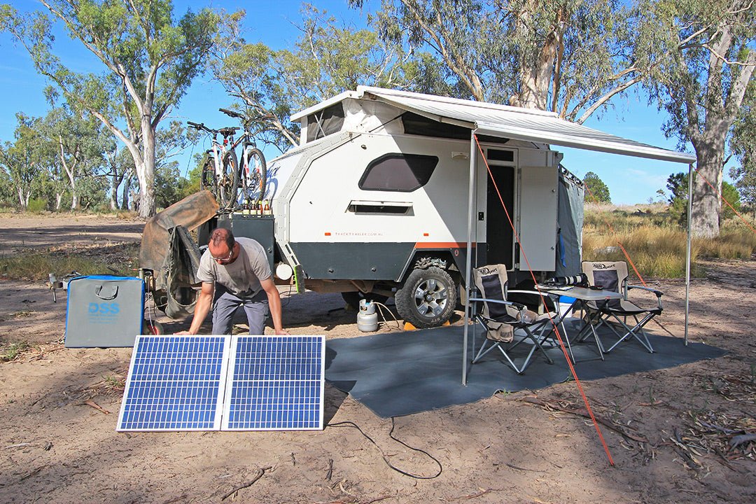

Thanks for your question. Having more power (stored or generated) is definitely popular at the moment as many RVers upgrade their vans. The advantage of adding additional solar that is not permanently fixed to the roof — such as a portable blanket or mat — is that it allows solar generation when the rooftop panels may be shaded. A solar blanket or foldable solar setup that plugs into an Anderson-style connector on the exterior of the van allows you to track the sun in direction and angle.

The J35 can produce up to 27A of solar at maximum efficiency, so adding an extra solar panel will work well. The 160W panel at a nominal voltage of 12V means that it would generate up to 13A of current. Therefore, a portable solar panel of approximately 150W or less would be suitable to add to your system. You could go larger in size to allow for inefficiencies of solar production such as the panel’s angle to the sun and shading.
