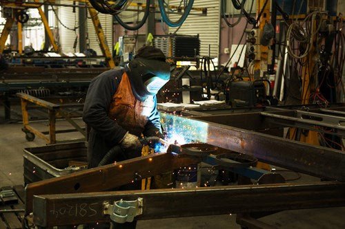

Lengths of steel come in from Jayco’s supplier, pre-cut to size. These are laid out on a table like a giant jigsaw puzzle before being clamped, then welded together to create the chassis main rails, cross members and A-frame.
The Jayco Expanda Outback sits on a 6.01m chassis, made from strong rectangular hollow section (RHS) steel. The Outback packs beefs up the Expanda’s credentials with 6in (150x50mm) main rails (compared to the 4in used on non-Outback models) and a 125x50mm (5in) A-frame. This gives the van greater strength and a higher ground clearance.
The Expanda Outback’s chassis has pressed-hole steel C-section cross members between the main rails. Hence the name, these rails are shaped a bit like a ‘C’ and have holes cut out of them, which reduces their weight. It’s still very strong and the holes allow the under-floor plumbing and wiring to be run through and stay protected.
