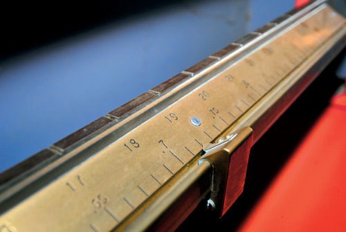

We obtained the ball weight in two ways. First, we weighed the van hitched-up to the tow vehicle, but with the vehicle itself off the metal pad. This gave us a figure of 720kg. We then un-hitched and positioned Betsy so that only her jockey wheel rested on the bridge.
The reading: 75kg. The discrepancy of 5kg could perhaps be put down to the bit of gas in the cylinder, if not the old-time scale in use at the weighbridge.
