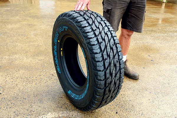

Understanding the information marked on the sidewall of your tyres is key to knowing how to care for them and whether or not you are using a tyre that’s right for your caravanning needs. It also helps you decide which tyres you should buy in the first place.
GOOD READING
The most important information on the sidewall of the tyre looks something like 205/65 R15 95V. It’s a code but you won’t need a cypher to decrypt it. The “205” refers to the width of the tyre in mm. The next part “65” is the aspect ratio of the tyre's sidewall and its tread rim, shown as a percentage. The “R” stands for “Radial” and “16” is the diameter of the wheel rim in inches.
A light truck tyre will have the letters “LT” or “C” (Commercial) as either a suffix or prefix to the tyre size.
After the tyre size is the service description (i.e. “95V”) this specifies load index and speed rating. “95” is the maximum load capacity of the tyre and the “V” indicates the maximum speed capacity.
Commonly, tyres will have the maximum load rating in kilograms and maximum inflation pressure moulded into the sidewall in smaller text. Exceed the load rating and your tyres will perform poorly or even fail. Exceeding these limits means you’re also driving an overloaded rig and your insurance company might not smile favourably on you in the event of an accident.
