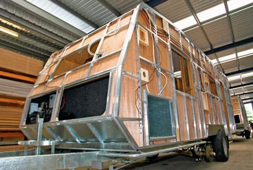

“Millard uses a 25x22mm (1in x 0.8in) and 25x25mm (1in x 1in) aluminium channel frame. Millard has used aluminium framing for almost five decades, which speaks for itself when you see the number of very old Millard caravans still going strong.
“We choose to rivet our frame sections together, rather than weld them, as this saves weight and allows the frame to flex as it travels over rough roads.
“Millard has chosen to stay with the aluminium frame because of its three main advantages over timber: it’s substantially lighter; has increased strength, especially at the joints; and eliminates the possibility of rotting wood problems in the frame, which means a longer life and lower maintenance for long-term owners.
“The disadvantage to the manufacturer is that an aluminium frame is much more costly to produce, both in labour and material cost. Our frames are not pop-riveted together. We hollow the sections, allowing the longitudinal and cross members to meet each other and give greater support than the average frame. We also place grommets within the frame to run the electrical wiring through safely.
“We place full aluminium framework around the fridge vents and windows and then insert timber into the aluminium to give added strength to the frame when these are screwed into place.
“In addition, the way we fix our cladding to the aluminium frame, with polystyrene foam underneath, gives added strength to the construction.”
